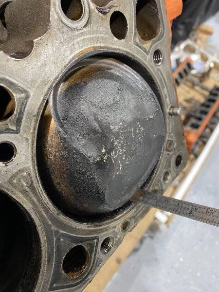

Just rotate one to TDC, measure how high the top of the dome is above the deck, then rotate it 180 degrees and measure how far down it is below the deck. Add that last measurement plus the first measurement and hopefully you'll end up with 3.75 (within a tenth of an inch allowing for the crude measurement). I would do it with #1 and hopefully the balancer is correct at TDC.

Ugh: Put together with mismatched parts. Could be stroker pistons on a standard stroke crank. Those could be 12.5 pistons with the tops milled off, hard to say. Not likely short rods as the piston skirts would hit the crank in most instances.

Good luck with the rest of it. Looks like it needs the heads rebuilt and a new set of pistons and a rebalance at the minimum.
Was about to correct the rod length, would check anyway, to stroker pistons.

I would almost bet my sister-in-law's reputation that they are stock 426 Hemi length of 6.860.

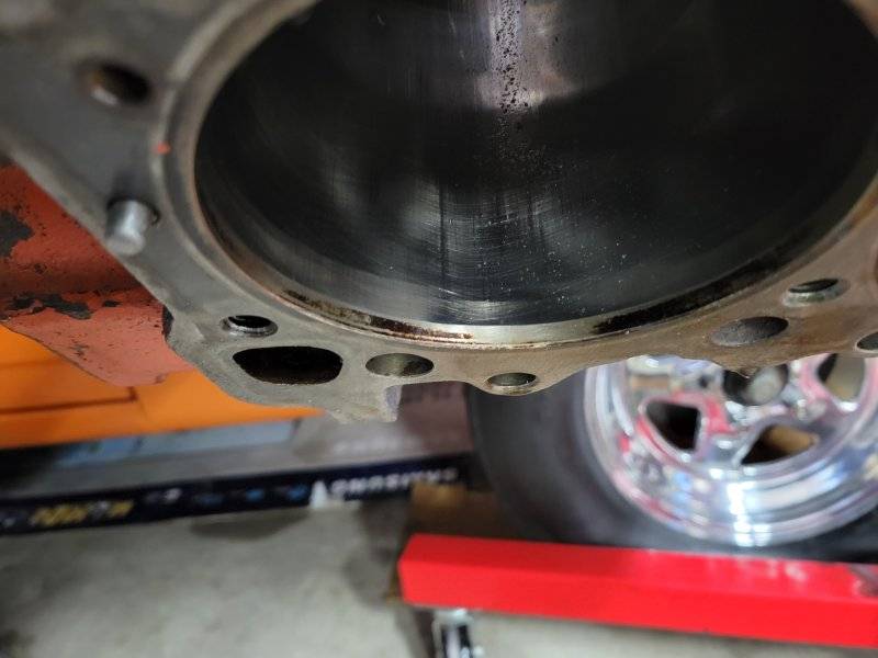

Were your pistons also recessed in the bores at top dead center?
I would say no. Could take a picture of a cylinder top, haven't progressed further, on light duty from open hernia surgery!
Here's a picture of a cylinder top, my pistons are out, but ring land seems pretty close to yours. Didn't measure it.
just a quick update, pistons were direct connection forged 12.5:1 pistons. They were milled to reduce the ratio. The rods are factory hemi rods 6.860. Stroke is standard 3.75. So apparently this is where these pistons were supposed to be in the bore at tdc. I'm having a cylinder head chamber cc'd and also a piston dome cc'd to get me the as built compression ratio. I'll go from there. Cam will be replaced as it measured after the ratio at only .450, really would like to go back to a solid lifter cam.
