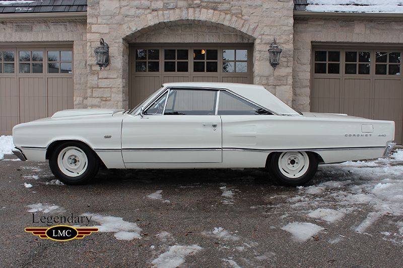

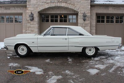

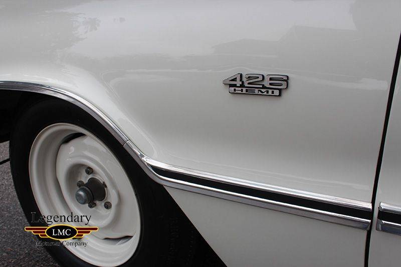

this should help you
I assume that you did not measure it.... or have a template. You are saying more or less that anywhere in the vicinity of the picture is OK?

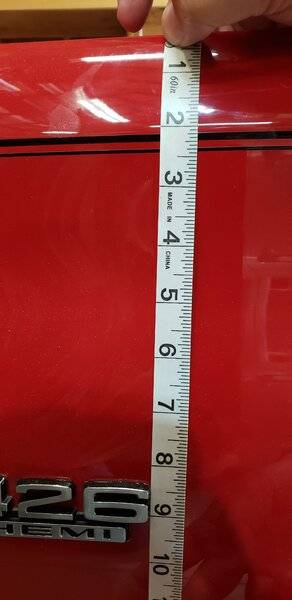

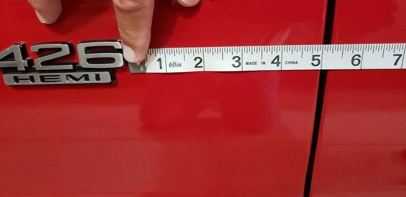

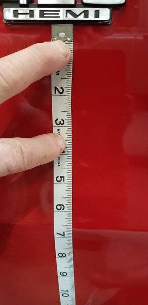

Hang on.... Just took some pics with measurements. I used a sewing tape. This is an original hemi car with original sheet metal.
Thunder
Yes... thats what i am talking about!
Thank you thank you.... Mike:thumbsup:
I would not take Peter Klutt's picture as gospel .. it even appears crooked. Thunderlugs on the other hand... :thumbsup:
