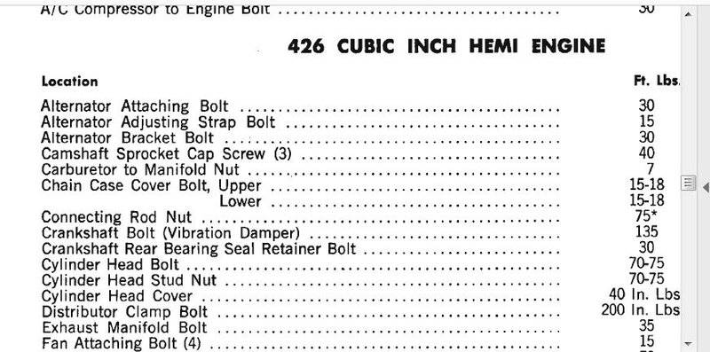

Don't forget to put hardened washers on before nuts. From 67 SM

All Chrysler Corp sourced documentation thru the years seems to spec 75 ft lbs final "All head bolts and nuts" except the '65 A990 Race Pkg Alum head "All bolt--nuts 60 ft lbs"....I've just always used 75 on street hemi iron with no problems or leaks.....IF >30 cracks, well it was Defective anyway.....30 seems like encouraging leaks, warps & blown fire-ring sealing issues.....

Iron heads I would stay with the factory specs. Aluminum it might be a different story. My Iron headed hemi is at the factory setting on all of them.
Here is one other thought. The wedge blocks are just about identical bolt wise. You do not see the wedge upper row at a lower torque spec.
My '69 came direct from factory with all 17 head fasteners tightened fairly equally.....Not experiencing any issues,.....I've continued to replicate that final 70 by doing pattern rounds of 35, 50 finishing at 75..... It's worked good for me the past 50 yrs or so..... just saying....Good luck for whatever you use,......tom
