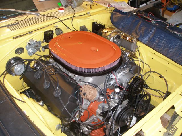

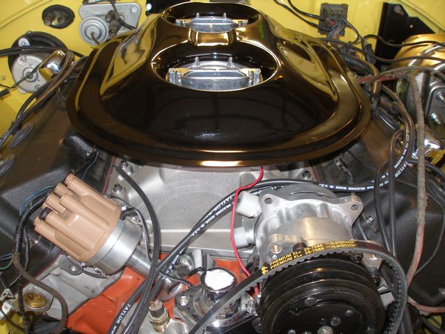

I have the Hansen Stage V heads and manifold.
Why would I NOT go with the STAGE V heads & Manifold?
1. The available dual inlet fuel line from the fuel pump to the carbs is designed for the Mopar manifold which places the carbs just a little closer than the Hansen manifold. You have to slightly bend the aft tube to align properly w/ the aft carb on the Hansen Stage V.
2. The "Original style" Air Cleaner assembly WILL NOT FIT on a Hansen manifold set-up. The Air Cleaner assembley in my pic is from Tim Banning at For Hemis Only. IT is the ONLY option, thanks Tim and FHO for ALL your help and the wonderful design and quality products!
3. I added Air Conditioning (AC) on my 70 Hemi. NOTE: Mother Mopars heads have a manufactured threaded "BOSS" on the drivers side head. It allows the AC bracket to mount to the drivers side head. THE HANSEN STAGE V head does not have this threaded BOSS. (Randy Bouchillion's BPE Products inc...BTW; All your help on this bracket and making it work for the Stage V heads! Thanks BPE for all your great help)
4. The throttle linkage and cable set-up has to be modified from the original MOPAR assembly because: you geussed it, the Stage V manifold IS different.
Now, yes...I have resolved ALL issues but, if i were to do it again, I would have gone with the MOPAR heads, Aluminum of course...
So, ask yourself: "Why not go with MOPAR OR INDY?"
Why do you want STAGE V?
Both Mopar and Indy are simmilar, where as Hansen Stage V is unique in these aspects.
Just my opinion BUT, again, the difference to me is significant.
(I did not know these things before but I know them know)
I HOPE this helps you...
Good luck and keep us posted.
