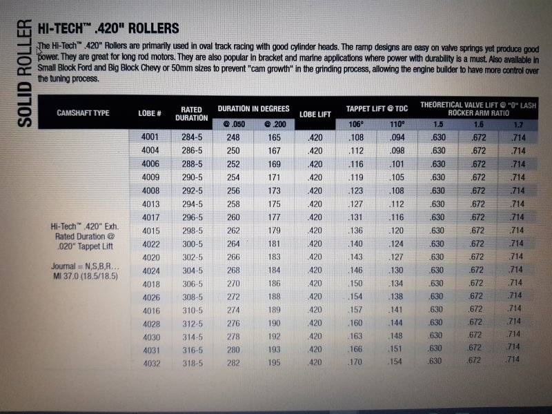

As others have stated, lobe ramp speed is the spec to watch. Your basic combo is nice and very similar to mine. A little more gear would be nice depending on your tire OD. I would be using less cam and less spring for what you are trying to do.
I've have found that for lifter longevity on a dual purpose ride, at .200" of lift, the duration needs to be under 200 degrees. Lobe intensity needs more spring than you want on a 90/10 street/strip car. Depending on installed height, 230-250 seat - 650/680 lbs max is what I'd be shooting for like a PAC /Comp 943.
The lobes below would be ideal for what you are trying to do and still make very good power.
Lastly, on a 90% street car, I would use a 112 LSA, it'll make more vacuum, idle better with a lot more initial timing and still make really good power.
If you need more info, PM me.
