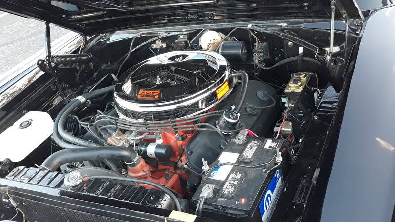

I like to use a the trusty chrome Accel coil or if you want a stock look, I use the MSD blaster coil.
It is red but I paint it black to look like a stock coil.
@Jerry Hall A painted MSD Blaster coil is what I used on your red 67 GTX
It's been changed, as well as the distributor.
