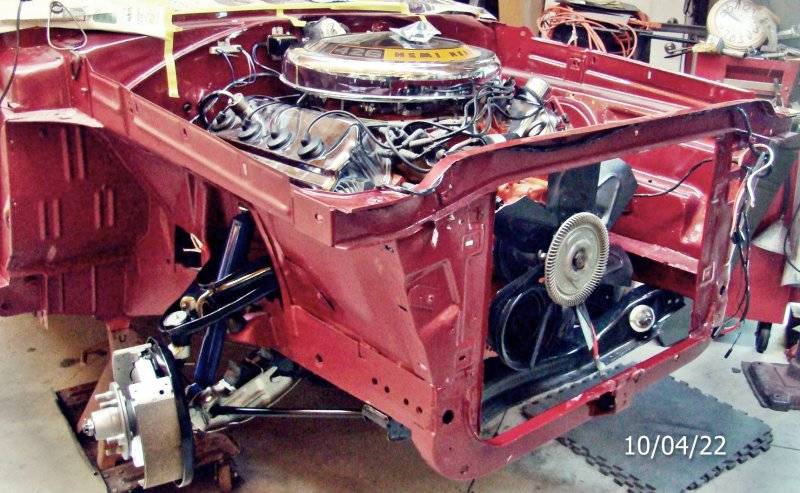

I am putting my K member all loaded with the suspension and the the whole nine yards (tires & wheels) Tuesday.
A friend here on B bodies (Big Bill) is backing me up.... kind of of nervous doing it that way.
My front fenders grill bumpers are off so i will have better access.
The whole body minus all the front components weighs 400 lbs according to my scales on rear wheels and tires..
if all turns out well ... some photos will be coming....
View attachment 1351776View attachment 1351777View attachment 1351785View attachment 1351786

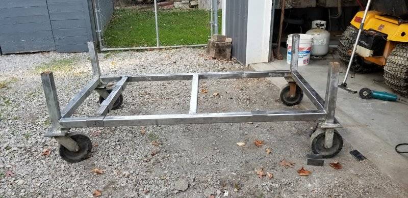

Where did you get that cradle? I'd love to have one but probably wouldn't make much sense to buy one to only use once.

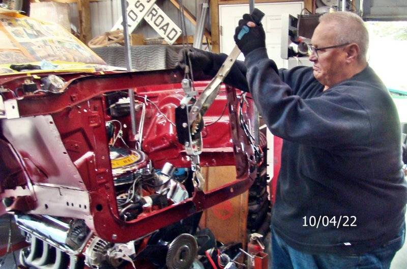

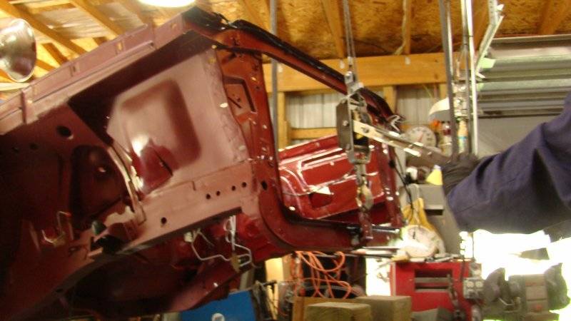

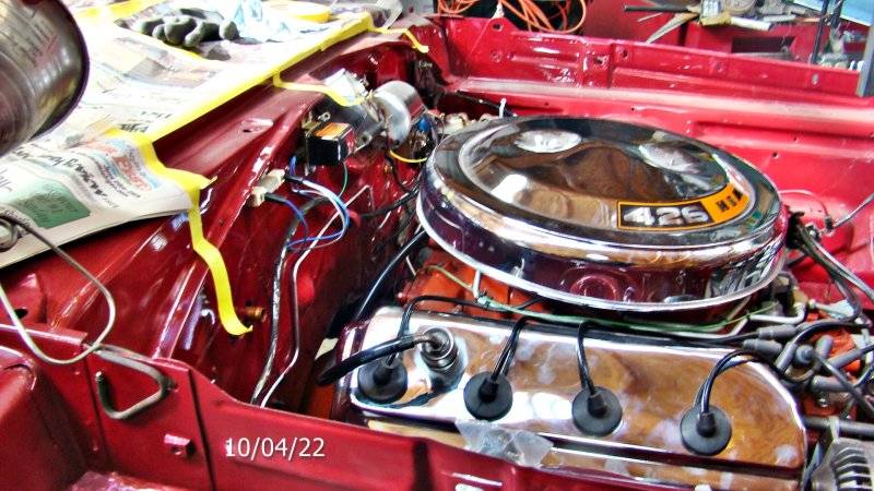

A lot easier with the no fenders....... bolted right up.

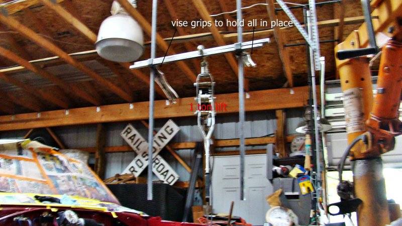

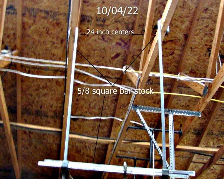

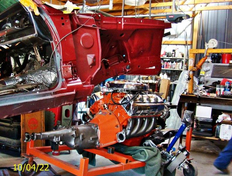

used a home made crane some 5/8 square bar stock and special connectors that I make.....
This will support 500lbs or the body weight with rear wheels on rolling jack stands on 2 2x4s.
Worked really well.
This I used to lift the body its self.

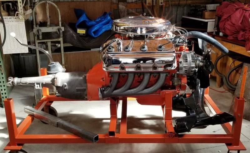

started with my home made engine stand that i made several years ago.
now i am going to scrap it....... it takes up to much floor space.
To bad you did not live closer.. you could have it...
