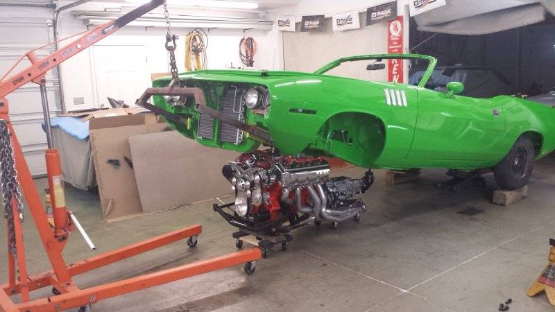

Last December 2021 I installed my Hemi from the top into my 67 Charger. My only issue was the driver side exhaust manifold clearing the power steering unit, so I removed the exhaust manifold and dropped it in. I had the car on a 4 post lift, so installing my transmission was not an issue with my transmission lift.
