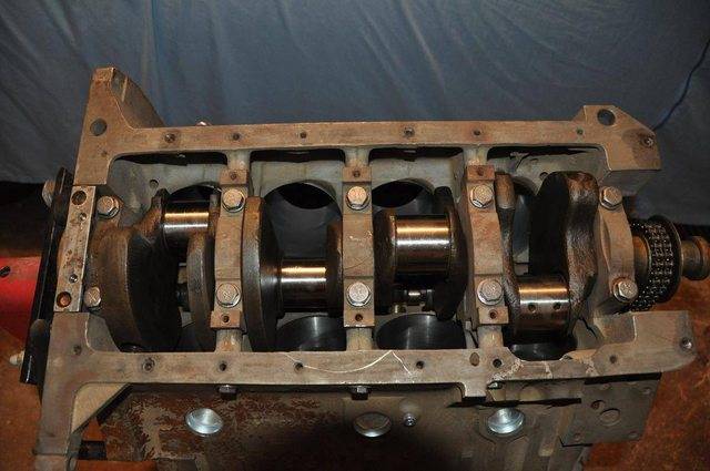

Here's what I'm talking about......you can see the drilled/tapped holes on the 2,3,4 caps. This block is a '64.
For taking the caps off. Put a bolt on each side and use pry-bars under the heads to pull the cap out.
