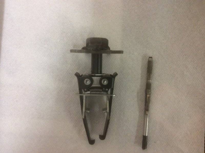

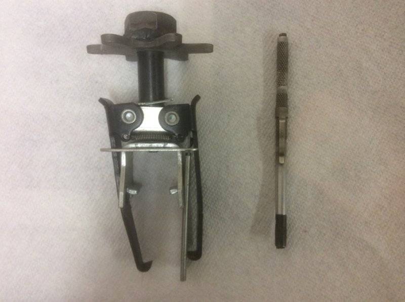

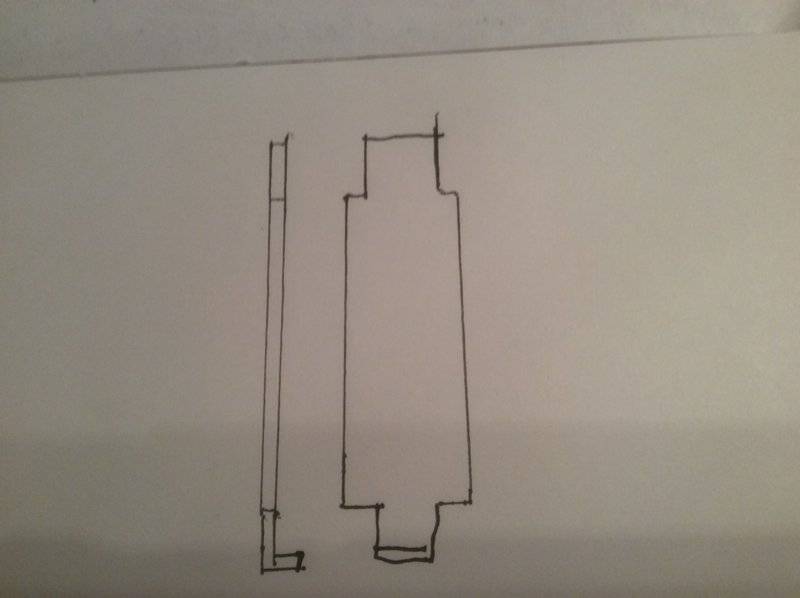

Changed springs on my 65 dodge with a Hemi. One problem was spring when compressed curved. Could push hooks off spring. Put a hose clamp around spring and compressor arm to keep arms in place. Made another long arm and put it inside short arm to pull spring evenly. See picture and crude drawing. The thing next to compressor has a magnetic tip I used to remove keepers. You may have to do some engineering :D of your own to get it to work but if I did it I'm sure you can! Going to look at it tomorrow again on making that second long hook. The shoulders on hook think were made to keep hook from just sliding up and not doing anything. Picture 2 is where I put it. Couldn't find my hook, dam.

Changed springs on my 65 dodge with a Hemi. One problem was spring when compressed curved. Could push hooks off spring. Put a hose clamp around spring and compressor arm to keep arms in place. Made another long arm and put it inside short arm to pull spring evenly. See picture and crude drawing. The thing next to compressor has a magnetic tip I used to remove keepers. You may have to do some engineering :D of your own to get it to work but if I did it I'm sure you can! Going to look at it tomorrow again on making that second long hook. The shoulders on hook think were made to keep hook from just sliding up and not doing anything. Picture 2 is where I put it. Couldn't find my hook, dam.View attachment 846199 View attachment 846184 View attachment 846186 View attachment 846187
I just used the HF variation of that KD tool. Total pos. The tangs don't have any "hook" to them to grab spring. I used a zip tie to hold it all together, and I was cranking that tool, wearing gloves, tried a socket on one of the handle "star" wheel - No Dice. It got to the point where I could not tighten any more and keepers still were not exposed enough to get out with a magnet.
It is a pita. I had to push down on tool to compress damper and inner spring to remove keepers. Agree lousy to work with but when its all ya got....
