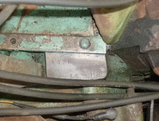

I think the engine pad beside the distributor bolt would be stamped A 42. A =1965 42 = 426

Here is the pad on my '65 Monaco 426 SW 4-speed car.

If the price is right a '65 Satellite is a great purchase. Check the stamp pad by the distributor to see what it might tell you.
