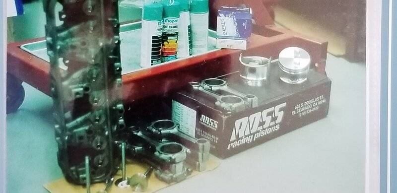

My 426-S was built with Ross Racing pistons, 0.20 over..also balanced /blueprinted.
