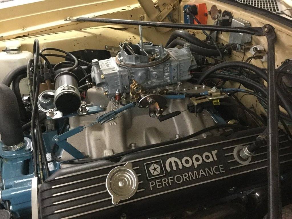

Mines from Bouchillon performance, performer rpm, Holley 1850
My car is a 73 satellite I think the crossbars are original for that car. My engine builder installed and set it up he said he liked the setup.
And coming from him that is good because if he didn't like it he would have told me so
