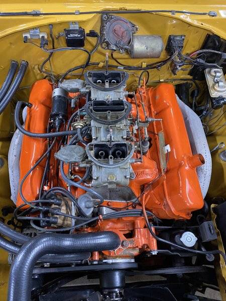

I concur with R413's assessment. See a pix of my RS23V0A****** GTX with the origional Prestolite dual point distributor. There is ample room for it under the air cleaner base. The origional 1969 1/2 RR with the lift off hood was similar. I can't speak directly about any after market distributor, except, pethaps, the Mopar electronic ignition ignition conversion, which would fit just fine.
Yes... the wires are incorrect.
