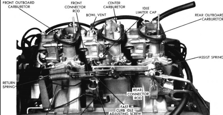

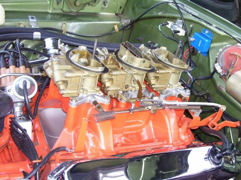

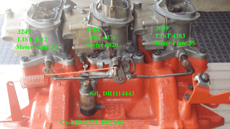

I need some pics of the carb linkage & spring set up of a six barrell set up. Must be an automatic trans set up. Thank You !!
Also does anyone know where to get that little clip.

this?
Just an FYI - on the other side of the six pack, the "outboard return linkage".....make SURE you have the rods oriented in/out correctly. Otherwise, the back one can just barely hang up on the side of the intake when you floor the motor.....engine goes wide open and stays there.... ask me how I know
My old '70 auto set...........(with a '71 solenoid).......never could find KD linkage for my 4spd, hmmmmm........:lol:
The '69 440+6 had the hot idle solenoid. And the bowl screws were slotted head not hex head. Repro carbs used hex head bowl screws. I believe the PCV valve for '69 was on the passenger side valve cover....

Wrong.....all the 440+6 engines had the hot idle solenoid assy.....yours may/may not have had the solenoid but they all came OEM with it.....plus the 4 speed trans did NOT have or need "kick down linkage" ...but ALL had the end carb closing linkage to force the end carbs closed after WOT if the vacuum open signal was slow to dissipate. Just my opinion.....
