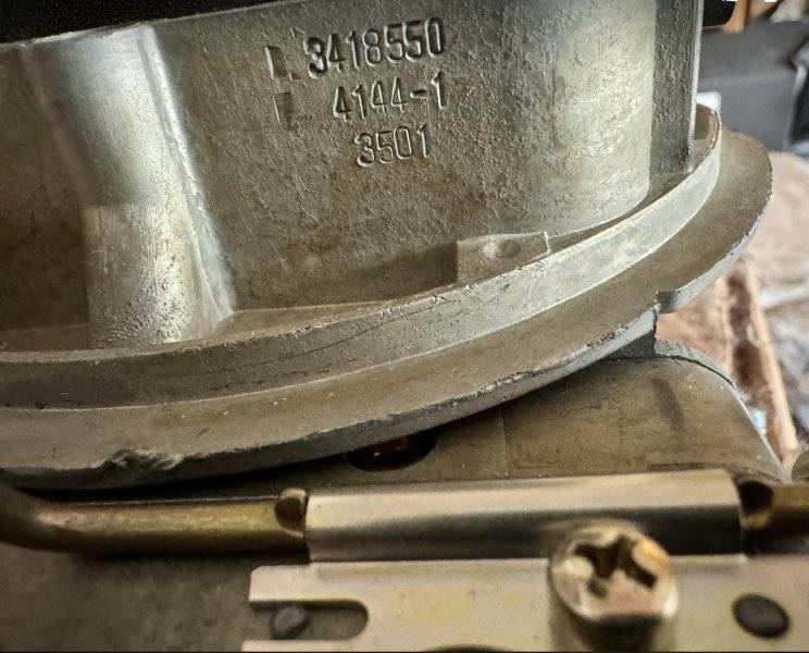

4144 is 1970 440 automatic. If it has the original float bowl it had a breather connection for you 3 port breather.
show a picture of the float bowl.

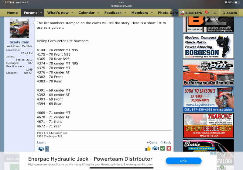

To answer the original question, yes, the '70 4144 with the enclosed idle bowl vent valve will work fine on the ’71 three nipple breather ECS system. No major functional difference between the ’70 California only N95 and the ’71 all federal N95 ECS systems.
The Holley R4144 shown (dated 3501 mfg 350th day of 1971) is a Holley aftermarket/replacement for the origional Holley 4150 R4375 (4 speed trans) OR 4376 (auto trans). The other numbers on list are correct for the years listed with minor calibration changes for auto trans vs 4 speed trans. ALL 1971 and later carbs have different center carb fuel bowls due to 50 states adoption of evaporation fuel storage methodology and a three nipple pcv inlet device....fuel vapors are stored in crank case (engine off) and are purged thru pcv system (engine running) and a fuel vapor separator at the fuel tank. Newer years, 1971 and up have different emissions restrictions for leaner operation. Additionally, the float bowl screws were hex head vs slotted head screws. N96 COLD air systems were calibrated slightly richer in off idle transitions. The front sbd rear carbs were 4160 series with fixed jet plates (metering orifices). My 1970 GTX RS23V0A****** with the N96 option used the 4150 R4375 center carb and R4382 and R4383 front and rear respectively. I've retro-fitted my end carbs with the Promax jet plates to be able to stagger jet the carbs for better fuel distribution snd more even fuel delivery. Just my opinion of course.....

Not sure I’m following the 4150 & 4160 references Bob, these two-barrel carbs are known as 2300 series Holleys, some similar attributes like metering plates. The original 4144 & 4374 California only center carbs used the same bowl as ’71, with the enclosed idle bowl vent valve. Agree, that date “1” date code year, not likely to be an original 4144 ’70 production carb. Besides the later Holley aftermarket, could also have been purchased as a standard Chrysler replacement part back then, using the original Chrysler part number. I was buying these through the normal dealer parts channels well into the late seventies from the dealer I work for then, pretty cheap too I might add. They were also offered through Direct Connection later, Mopar Performance, up until the mid 2000s using a later “P” part number. The “1” date code year could be ’81,’91, or even ’01. The re-issues were list 4144 for the ’69-70 applications and list 4670 for ’71, later eventually dropping the 4144 re-issue altogether.
The mentioned change to hex-head float bowl screw started with the re-issues much later, there were some other slight hardware/fastener changes as well.
