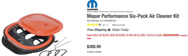

ha ha , I even thought of going crazy and putting a shaker hood conversion. Never seen it done on a 67 Bcuda ! Parts not cheap thou !
Rather than goldbay, If you go direct to Jegs you may get it 25 cheaper. You'll likely need it for the filter……...
