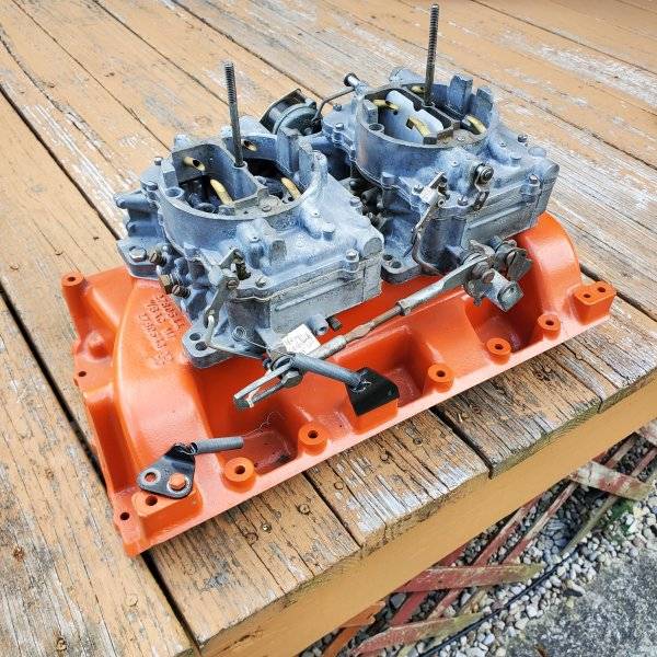

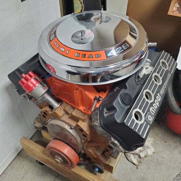

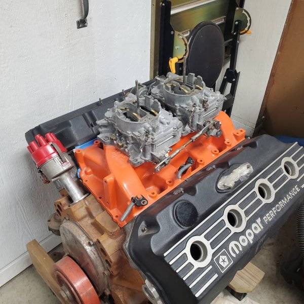

I recently picked this up for my hemi build. I'm looking for the Carter carb kits to freshen them up. I also have a Weber carb on my Challenger that needs a going through. Who, and Where does anyone recommend finding these kits ? Any recommendations appreciated, Thanks...

Original Carter kits come up on Ebay every once in a while. You just need to know what number you need. What are your carb numbers.
