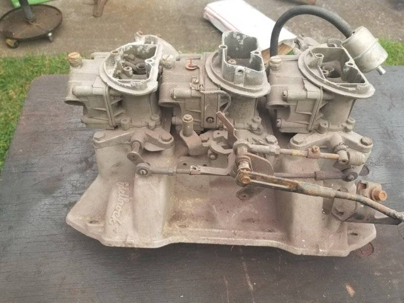

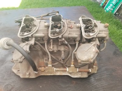

A few comments first.
IMHO....
1. Throw away all the fuel line pieces. Totally incorrect, fuel comes in from the ftont.
2. Some "expert" (??) Removed all of the center carb's choke linkage and parts, including the choke shaft and choke plate.
3. The same "expert", modified the linkage on the drivers side to mechanically open the end carbs simultaneously with the center carb....why?
4., Without totally dis-assembling the carbs individually, its difficult to determine if this "expert" modified any of the interal metering components.
5. Because the linkages have been bastardized, it is likely that the end carb diaphragms have been "modified" by the "expert".
6. Upon closer inspection and examination there may be other changes.
7. Are the carbs original (check the R numbers and build date codes) or they a different pieces and parts.
8. Are you making a tribute restoration or restoring a REAL V code car?
Rebuild kits are available from Holley, along with the replacement of the missing choke psrts. Standard motor products also sells excellent kits. Off brand rebuild kits use a modified fuel inlet adjustment arrangement. Depending on the degree of correctness you want or can afford, there are several very competent restorerers....not inexpensive though. How good a job can you afford?

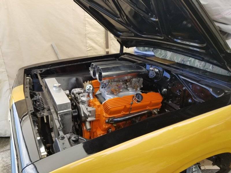

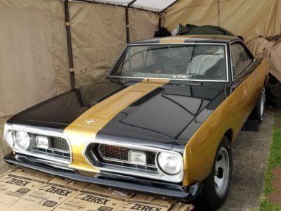

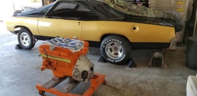

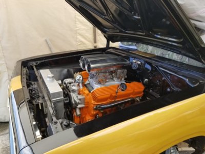

Aloha, and mahalo, My uncle gave me the set up !
He is the "Expert" and parts are hard to find here in Hawaii and he is old school. so he just made do with what he had.
I am not restoring a numbers matching car, I just want it to Look real and run damn good on my 440/6pac 4speed .
I am actually going to put it in my 67 Bcuda , but I thought I would talk to my brothers on FBBO as more of you have 6pac cars !
I will not be racing my car , so I just need it to run well. everyday use if possible ?
As I got the setup for free, I don't mind dropping a few hun. or MORE in restoring it back to factory specs. or a little better if so be ! Mahalo C

Perhaps you should go back to your Uncle to see if he still has the pieces he removed. Would save you a few $$.
To be brutally honest, the best thing your Uncle should have done was to leave it the way the factory designed it. There are just too many "experts" that think they know the "best" way to fix a non existent (but perceived) issue. It seems as if the day, when carb fundamentals were taught, they were absent that day.
Rather than fumbling and blindly proceeding, investigate several of the premier carb rebuilders mentioned on this forum. They have both the skills, parts, and experience to restore your items to origional appearance and functionality. My opinion: spend the $$$$ and have it done correctly by someone that knows how, even if it means sending back to the mainland.
Since you did not pay for the setup, spend the $$$$ to make it look correct and function like what you expect. My guess on the approximate cost to restore all stuff to like new appearance and functionality is: $1500-$2000 including shipping to/from the mainland.

Your setup is in better shape than mine when I started. I strongly suggest you put it all back stock & work from there. The "old school" tricks I used on 6-packs back in the 80's didn't work very well. I suggest you see if you can find some "pin gages" or small drill bits to check the various holes. The main places to check are the power valve holes (behind the power valve) and the fuel bleed holes (name?) on the top/outer edges of the end carburetor metering plates (these holes are often drilled out).
