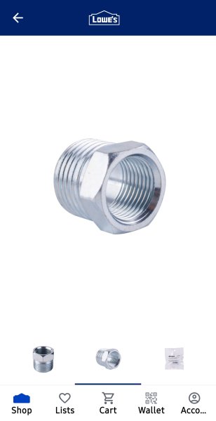

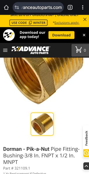

You can always tap it to 1/2", then use a 1/2"x3/8" bush to put your original pickup back in. IIWM, i'd use a harder set threadlock on the 1/2" threads.
not terrible idea , but if I were going to drill it and tapp it for 1/2'' , I`d sure buy a 1/2'' pick up and put in it .

No such thing as Heli-Coil NPT anything as far as I know but, on the other hand, Timesert has a kit PN#0318 to repair a 3/8"NPT hole. It is expensive for the casual user, and the larger hole can be a bitch drilling by hand. I tried to get the drill size, but it is not listed. It would be cheaper to get a 1/2"NPT pickup and attempt to drill and tap for that. The threads on the 3/8" pickup might be worn (in addition to the worn hole threads), and a new 3/8" pickup with red or green Loctite might work too. I like using green Loctite for sleeves as it dries much faster. I used it once on a sleeve for a Ford 390, and it locked up halfway into the block.
