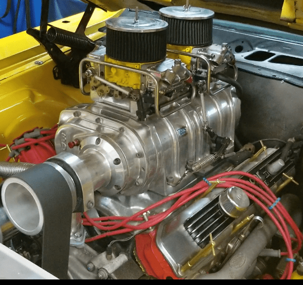

Here you go. Here's a "hellcat range" 440.
I don't really know how much it cost to build because I didn't build it, it came with the car I bought as a unfinished project and only has 100 miles on it. I would guess $25k atleast. I know the BDS 8-71 blower and drive alone cost 10k and every other part on it is top notch. If you can live with the 8-71 you could drive it around but I know the hellcat gets atleast 2x the mpg.
