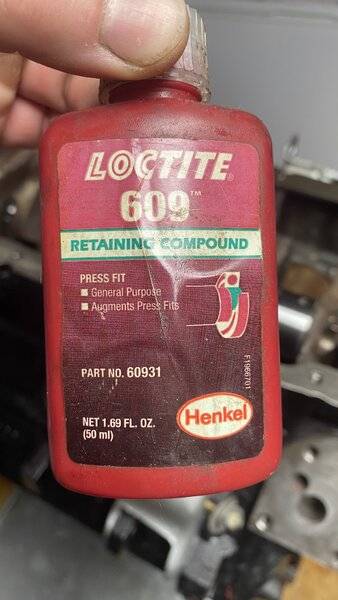

I beat the bearings out, bought a new set, grabbed my whizzy wheel spinner with the long end and put an extended end on it (for her pleasure of course) and massaged the holes, gave the block a 1 1/2 brake clean bath, and IMMEDIATELY ruined the rear bearing cause the tool got shy and slid inside, but got the others in, used some green loctite, it’s for retaining bearings
Got a whole new set of bearings, beat the rear one in like it owed me money and slid the shaft in her slippery holes and she feels so good!
I can spin the cam from the bolt and washer, I’d say it takes 5 ft lbs to spin, put my drill on it and spun for 20 seconds (with the ultra sticky break in install red lube) pulled cam out and no metal on the cam

This is the super special retaining loctite, works good, it’s a good trick to have in the tool box
