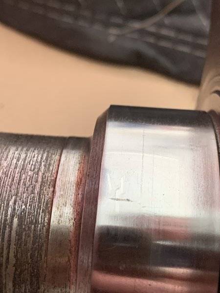

I bought this crank from a machine shop on eBay. Listing said magnafuxed, hot tanked, superfinished, “ready to go”. Mains are std. and rods turned 0.010. I was surprised to see the lines and gouges on the mains. If polished (looks like it was) and spots not raised should I install crank as is? I mic’ed the crank and it is std/0.010. See pics below.

It's an ebay crank go have everything checked out by your own machine shop and see what they say.

Tell the seller you want to return it. I would not accept it.

Looks like it was assembled and stored for thirty years. That's from moisture. If it Mags O.K., you can use it.
If you feel that you want it more perfect you can have the mains ground. It all depends on what you paid
for it. I do agree that if you paid too much for it you should return it!

Spoke to the shop directly and he agreed to refund $175 back to me so I can get it turned here in Fl. Didn’t give me any push back. I paid $350 for it plus $65 shipping.

Also this is a car show car and not a race car. Won’t see 5k rpm hardly ever.

Grinding a crank under is no biggie unless it's a Nitrided Hemi piece. Have the rod
journals chamfered while you're at it. It'll be like brand new.

Grind the damn thing R20/M10, don't even think about it, and be done with it as long as he is going to return $175. Here, that is more than what the crank grind price is.

Small dings or small pits on a crankshaft don't bother me too much as long as there are no raised areas and the crankshaft measures out like it should.
