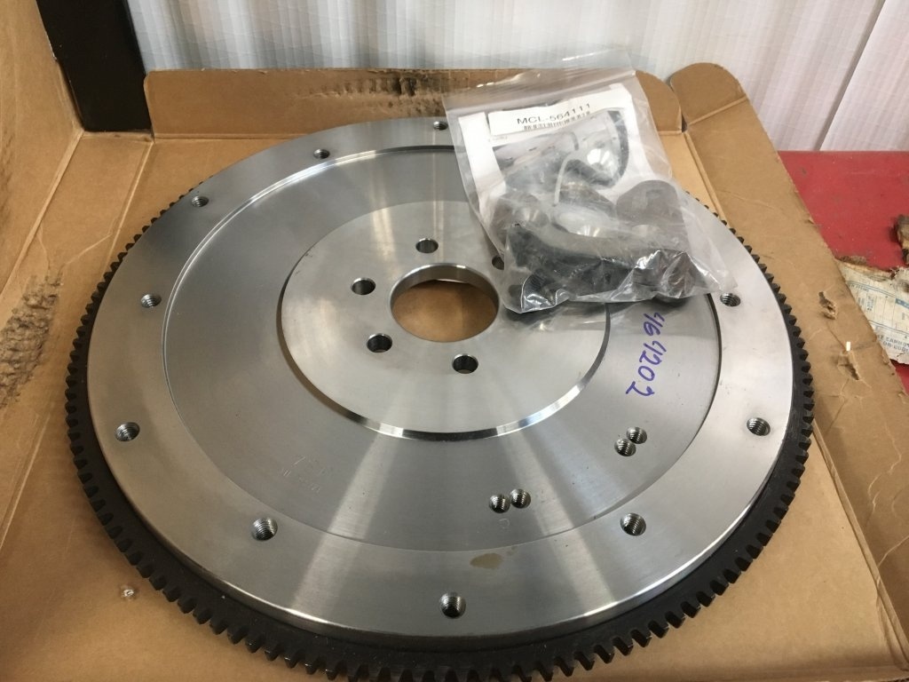

I'll get the part number for the McLeod it has a removable weight for cast crank motors and of course leave it off for forged crank motors. It's what I use on my engine run stand for big block mopes
Another source for this bolt on , simple method for cast or forged crank is from "440 Source" Manufactured other than USA , but low priced and I was impressed with mine...........................MO

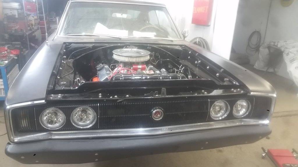

Car is all assembled and kicking ***.
I used Brewers for the flywheel, clutch and all related parts. They really know their stuff.
Motor is a 1975 440 with whiplash cam, edelbrock intake, edelbrock 850 carb. Summit headers, 1975 A833 cast iron overdrive, 3:91 gears.
Reverse arm O-ring is dripping but other than that it's turn key daily driver. Rain or shine
