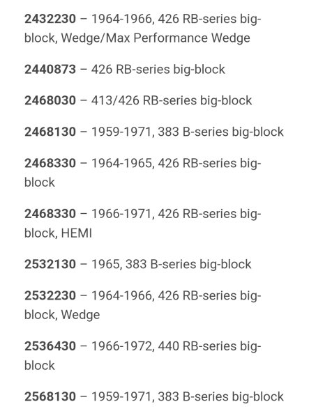

I have a opportunity to purchase a complete 440 can anyone let me know what the upper and bottom numbers are

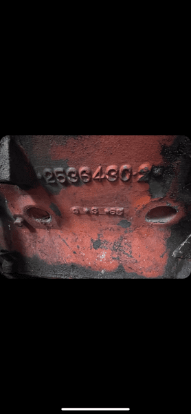

The date on the side of the block I can not tell what the last number is
If it is a 69 it might have made it into an early 70 model car as they did sart building them in 69
As for if the crank is driled for a 4 speed or not to be sure I think you will have to look at the end of the crank
I think most were drilled in that era
Looks like it was cast 6/3/65 to me. Probably came out of a 1966 car.

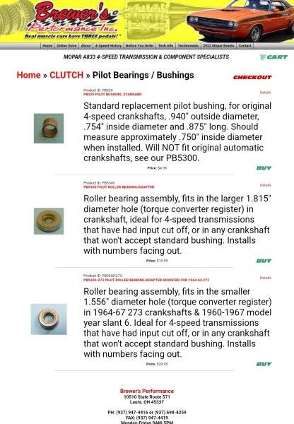

If it doesn't have the bushing it's no big deal, there are affordable options to add one from Brewers.

The motor is definitely a 1966 cast but there no numbers stamped on top pad. I have a 1970 383 numbers matching original I wanted to put a 440 in for me will it hurt car value as long as I keep original motor. He said was in a 1970 coronet but I do not know why they have no numbers stamped on top
It could have been in a 70 Coronet when last guy found the engine does not mean it started out in a 70 Coronet :)
