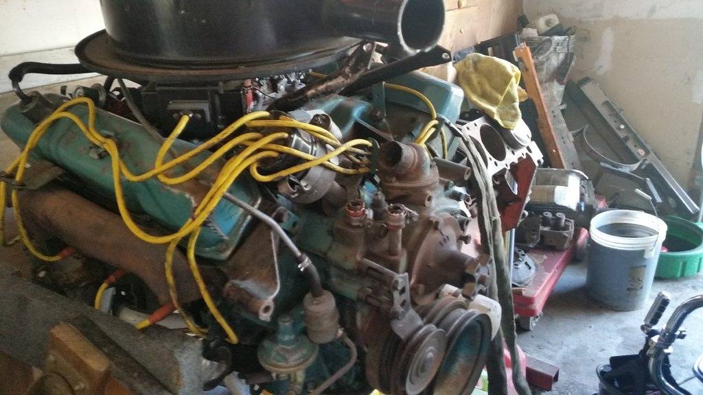

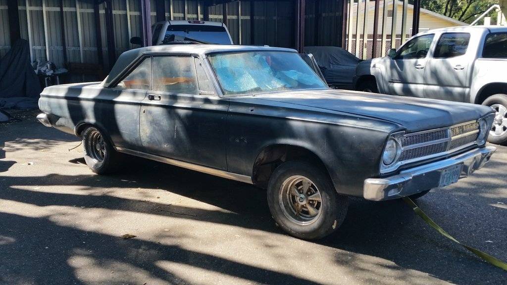

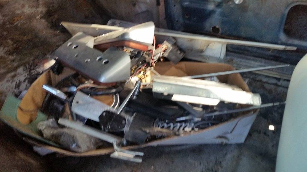

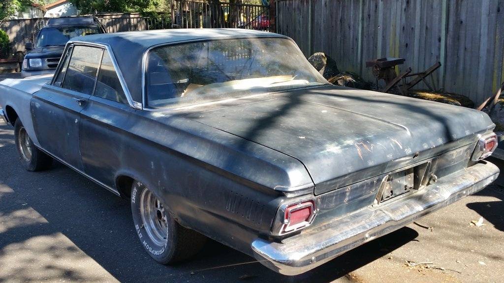

1965 Plymouth Satellite Original big block 4 speed car. It has a little rust on the bottom rear of quarters and rear wheel lips, the rest of the car is solid, I comes with Legendary Upholstery headliner, carpet kit, seat covers and new buns they have been installed, and door panels, but missing one rear one. I'm sure Legendary would just sell one. car needs to be restored by is a solid start . The 4 speed is still in the car and I have a complete unmolested low mileage 65 440. Yes it is a 65 motor most say they didn't make one. The numbers don't lie. $7,000 I have several other 64 and 65 Dodge and Plymouths for sale and parts.

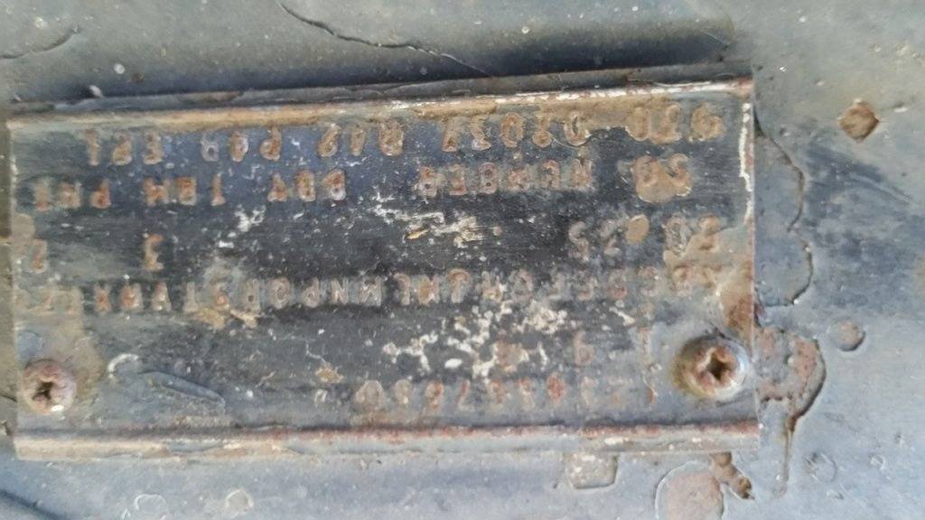

This is a complete untouched low mileage motor the stamping on the tab is B440 and the side of the block is cast 7/2/65 so I guess it could be technically a 66? I believe b is 65 too?
'65 engine stamp is an "A". I have two '65 Satellites and I purchased a '65 "A" 413 engine and transmission a couple years ago.

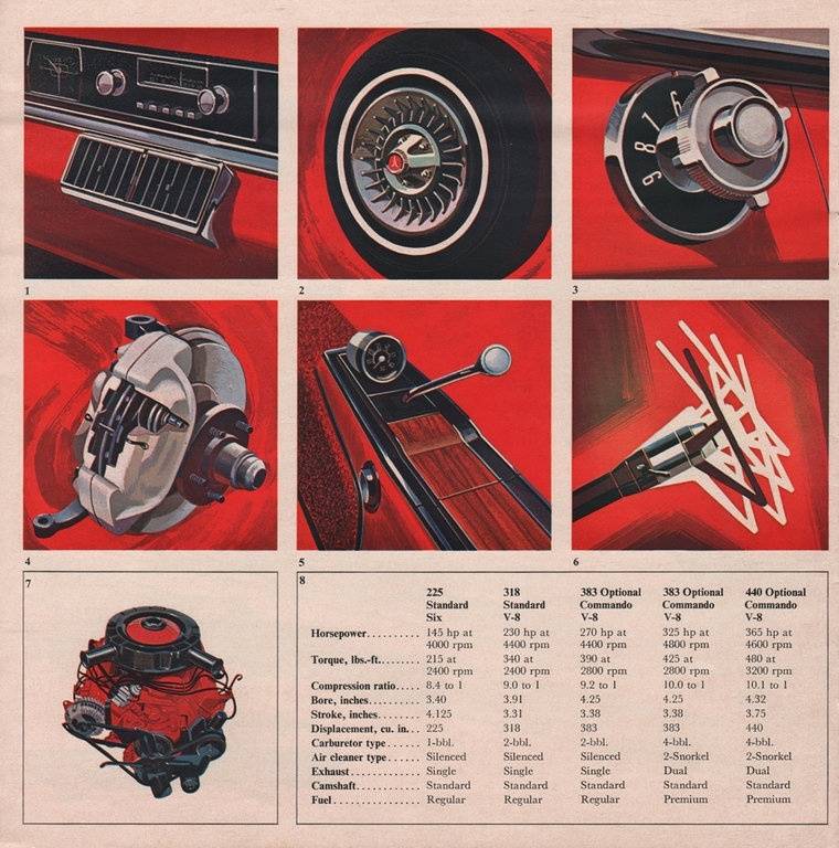

Sales brochure for the 1966 Plymouth Fury featuring the Sport Fury, Fury III, Fury II, and Fury I in 4-door sedan, 2-door sedan, convertible, and station wagon body styles. Engine options include a 145hp 225ci 6-cylinder, 230hp 318ci V8, 270hp 383ci 2-barrel Commando V8, 325hp 383ci 4-barrel Commando V8, and "365hp 440" 4-barrel Commando V8. "I duzn't cee no 426/365 Injun Opshun. Jus' sayin'... :thankyou:

Plymouth DID have a 440 option, for 1966. Dodge Monaco car model, Chrysler, & Imperial too. NONE of these are B-Body cars...as most of us know. As stated in the brochure that I posted (and other places), it was a "440/365" horsepower rated engine, NOT a 426/365. Again, the Fury I, II, III, & Sport Fury "C"-Body, full frame, cars.
