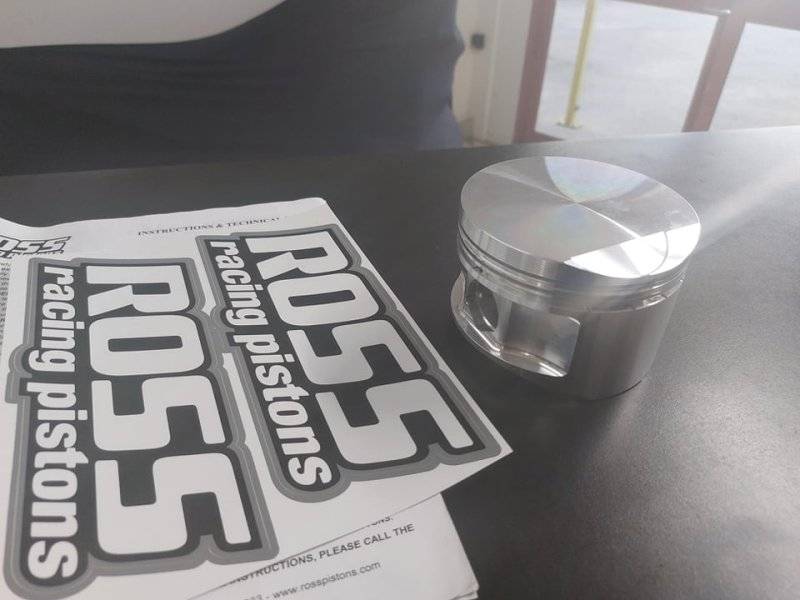

I hate to give more bad news but this will only get worse as you get some carbon buildup in the cylinders.
My engine builder put a quench pad in the pistons but I still have problems so I think you are right.
It's a shame because it's a nice torquey engine that can easily pull the high gears at low revs.
Lowering my compression or putting in a bigger cam is on my list for future modifications.
