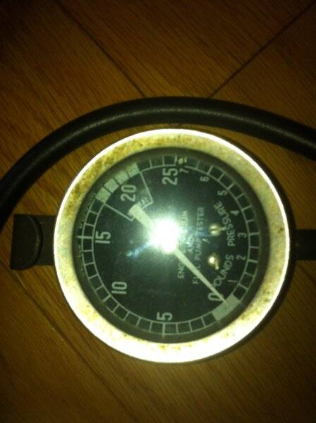

get yourself a gauge like this (vacuum and fuel pressure tester) or just a fuel pressure gauge. It should be around 6 psi.

Check fuel pressure to the carb , like posted 6lb max on eddy.
