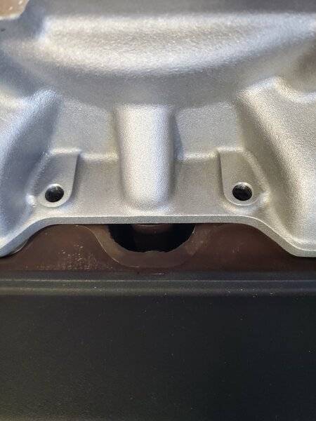

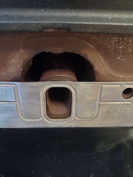

Hi everyone would appreciate any help I could get Novice here trying to restore my GTX, I have my Intake manifold gasket/Pan and not sure about the U shaped holes in center that gasket and my Intake doesn't cover. Thanks

Can I paint all of that not covered I'm using Hemi hi temp orange ? Thanks

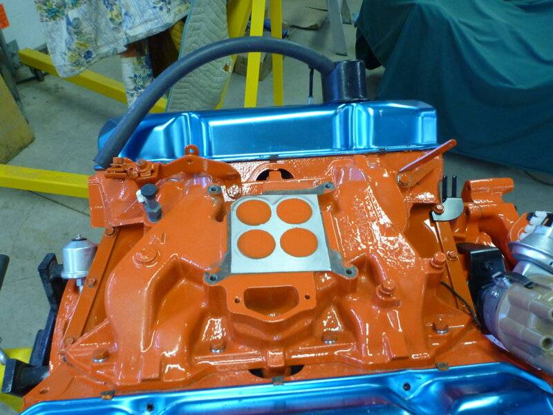

Paint isn't going to hurt anything. It's just an air gap in the casting.. just don't throw stainless lock washers under the bolt heads like my painter did..

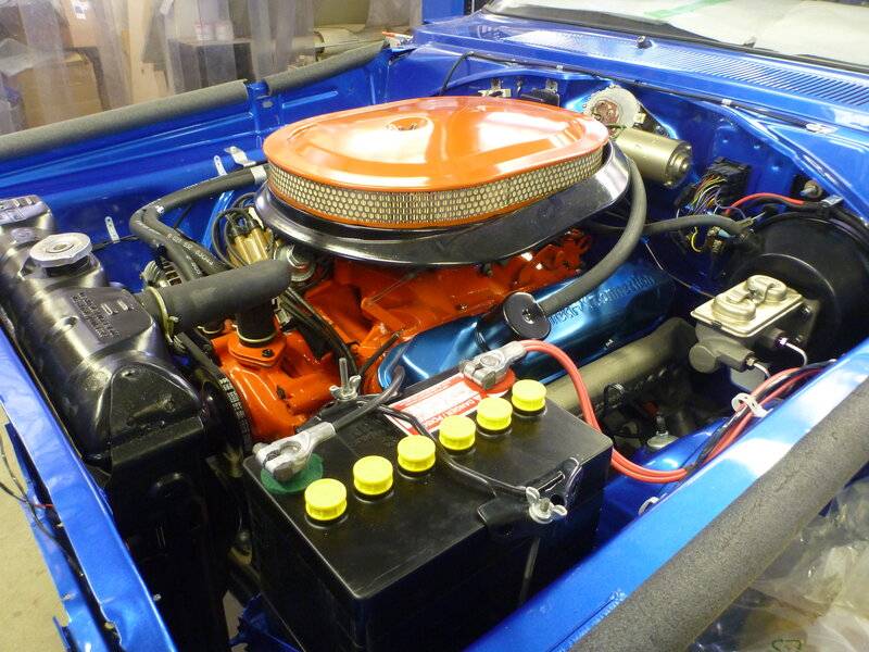

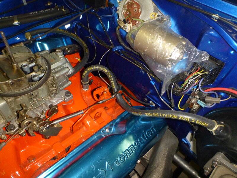

Thanks that sure looks awesome I see the hose going to back of Intake from valve cover my block has the nipple there I thought that was for oil pressure gauge if wanted?
As you can see I am learning and reading and watching everything I can find I appreciate it
That breather hose is just sitting there, it connects to the air filter assembly. Oil pressure sender is shown at the back of the block for a 0-90PSI rallye dash, yours may just be a smaller "switch" if you have a light only. Nipple on the intake itself is for brake booster vacuum.

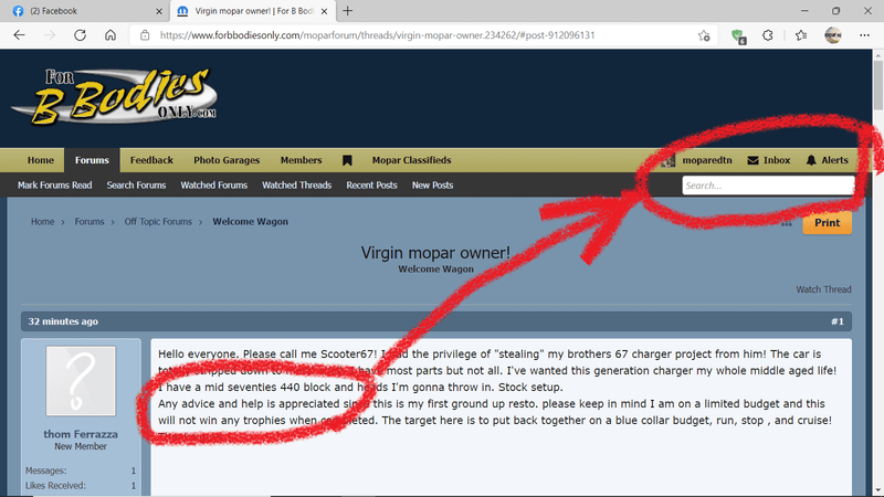

Make liberal use of this site's Search Box, located in the upper right of every page. :thumbsup:
