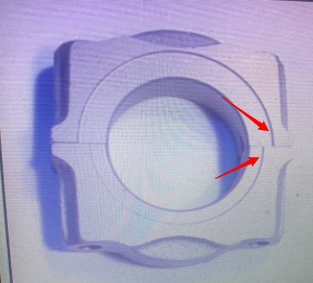

What's throwing doubt my way is the thrust bearing I have being too wide. I can as advised carefully sand it down to fit. Another source I read that external balanced 440s started in 75'. That source said the thrust bearings were different in thickness from the early to the latter. Thinner in 74' on back. Wider 75' till 80'. I think I have the older crank, which is internally balanced. I can pick up a used balancer and flex plate reasonably just to be sure of what I have. If wrong it will cost me time to reinstall the bigger balance and flexplate which I have.

The thrust bearing side walls are taller, the bearing isn't wider.... Look at these two caps...
So, unless you have an early block (you don't) it's a non-issue...
Have you tried backing off the center main bolts & tapping the crank fore & aft? If you have and you still lack end-play I have used 600 grit on a flat plate (glass) and WD-40 as lube... to pick up a few thousandths...

It's a reground crank, 020. No, the problem is I have zero end play. The suggestion is to sand the thrust surface of the bearing carefully with 600 carborundum paper wetted with WD40. Rechecking so as not to take too much off.
There is no measurable clearance between the bearing and the crank. So centering the cap is unachievable. I will consider that upon reassembly.
