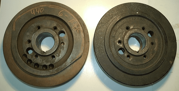

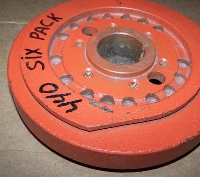

The 70-72 forged crank big rod engine had a thin damper that has an offset weight, it is externally balanced...
Here's a standard 440 internally balanced damper next to a 70-72 big rod externally balanced damper
And a side shot of the big rod damper.... AKA Sixpack damper
