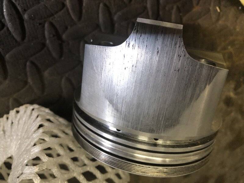

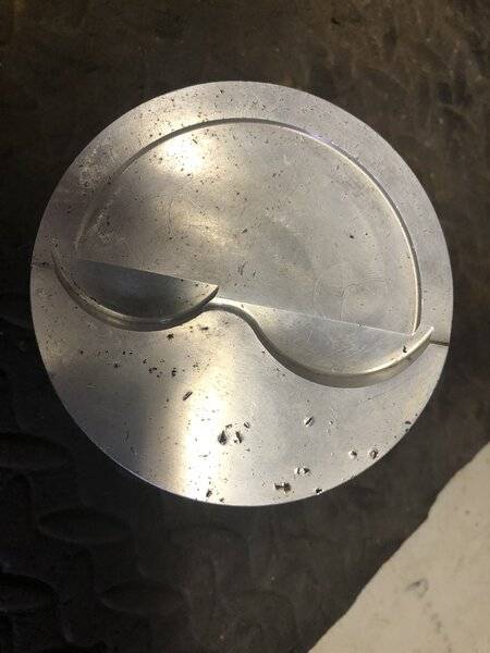

motor was rebuilt 1500 miles ago
#'s on the piston are I c 836 030 on one side and PR 11995 cylinder was re-honed for light scratchesmotor was rebuilt 1500 miles ago

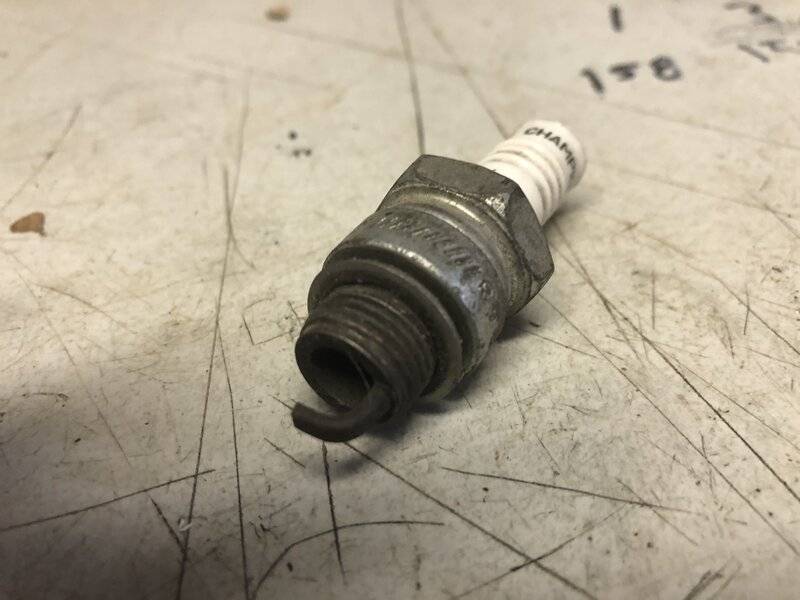

how is it possible for debris able to jump from one cylinder to another !!!Did you collect all of the spark plug pieces? Did you take apart the cylinder head and inspect the valves and check for debris?
Usually, when something like this happens, the debris will end up in other cylinders as well. Pull both cylinder heads.
i have the same oil pressure before and after the knocking and the motor has no missinghow is it possible for debris able to jump from one cylinder to another !!!
It's called reversion.When sun-ting-wong,debris can get into every cylinder.DON'T ask how I knowHad a piston come apart at the race track once. Debris got into EVERY other cylinder!!
