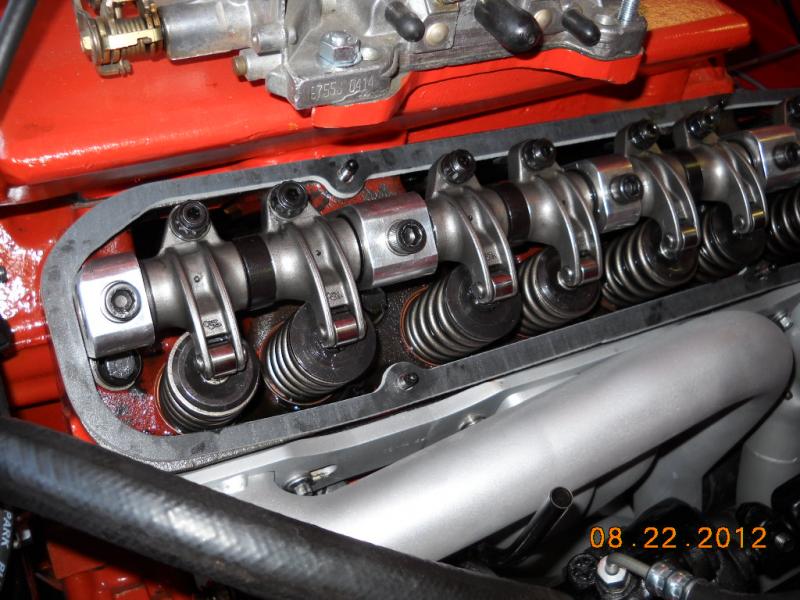

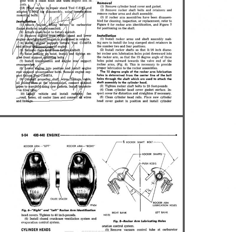

I'm still trying to find out which way the rocker arm dimples (pushrod indent ) is oriented. Are the left dimple & right dimple opposite of each other or are they to the near side of each other ?????
Chuck
EDITED: The pushrod cups (dimples) are facing each other, as the picture below shows. So the first rocker (exhaust) on cylinder #1 should have the dimple (pushrod cup) toward the firewall and the second rocker (intake) dimple should be closer to the front bumper. Had a brain-fart...
