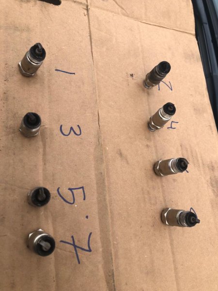

I'm in the process of taking the plugs out. So far they are a tan/grey colour with a small amount of black but all dry. #2 was loose and pure black. I'm having a battle with #4 to get the plug wire off and plug out. It's super tight to the shock tower
So myself and #4 had a little chat and it finally gave up the fight. I won
The #2 & #4 might have better access from under the car. Depending on headers ?
How loose was #2 ?
If you find another one or two off color plugs or loose replace or clean them up and put a new wire on them.
If you have extra cap and rotor I would slap them on as well.
Just seen the plug picture. Yep #2 is fouled from the looks of it and the rest are close.
That helps, Your running to rich. Your new plugs would help for a short time but until you back off the fuel they won't last long.
#2 came out with my fingers. It was shaking on the threads. After I did the cam break in I checked everything and some of the plugs had worked loose so they all got tightened home. As for richness I knew it was rich ever so slightly. Going to hook up my vacuum gauge and tune it. Thankfully new plugs are on the shelf. Unfortunately it's now raining so I won't get out for a drive
