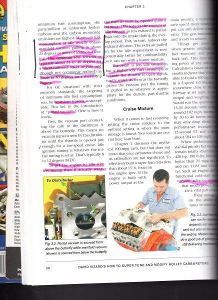

I can almost guarantee one thing that will happen: Unless you have AT LEAST 25* of timing at idle, your plugs are going to foul up again.
I may have already posted this, but it is worth reading again:
