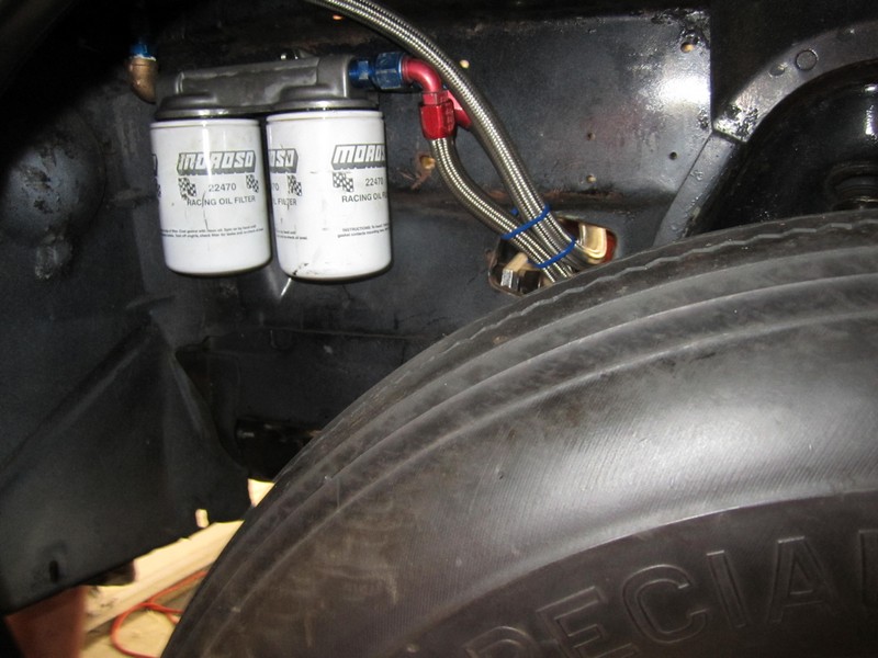

What happened to me would have been the same with any filter,but I was using a fram HP.The fram HP filter will flow about 10 to 12 GPM. My Milodon oil system flows 19 GPM at idle and increases with RPM.When 19 GPM hits a filter that flows 12 GPM the bypass opens and flows unfiltered oil into the oil system. I had a roller lifter failure causing total contamination of the engiigurene.It took some homework to figure out how all this crap got past the filter.
I now use duell Moroso filters that flow 16GPM each:icon_cyclops_ani:
