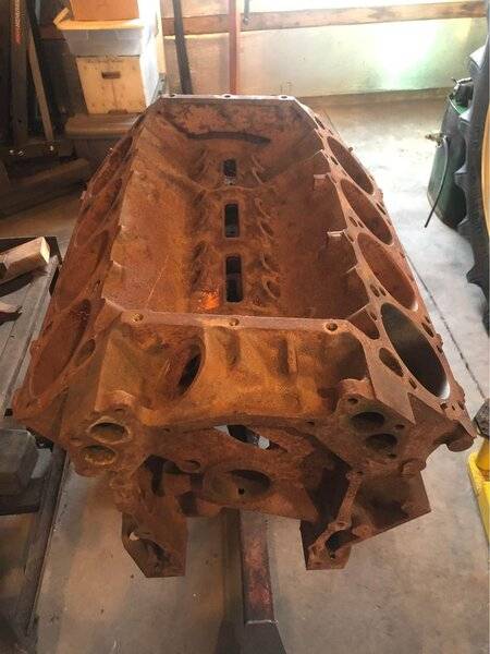

The only way I would consider building a block as rusty as the one in the picture is if it's original to your car. I would be very concerned about the lifter bores.

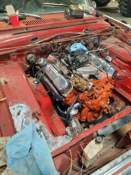

Engine is in our 65 dart, but it was a big project, still not running yet...so can't say how well the 440 pistons in a 383 works...

I’d also look for another block, more complete and rust free. Would spend a lot of time and money chasing down all the bolts and hardware needed (unless you already have extra on hand).

I found a good deal on a 1967 383 block close by, but it's already bored .030 over and the cylinders are pitted a bit and probably will need another .030. Do you think the block could handle another hundredth over that to get it to 4.32, and would I then be able to use standard bore 440 pistons in it? Or should I just forget about it since it's already so bored out. The only other 383 block I can find close by for a good price right now is $50 more, surface rusty pretty much everywhere, but standard bore (and it's a further drive, which does play into it a bit more with gas prices today).

I think going with the standard bore 383 is a no brainer. .060 over is stretching it, and you don't have room for an overbore if it is ever needed in the future. You won't regret spending a bit more to start with a solid block now.
