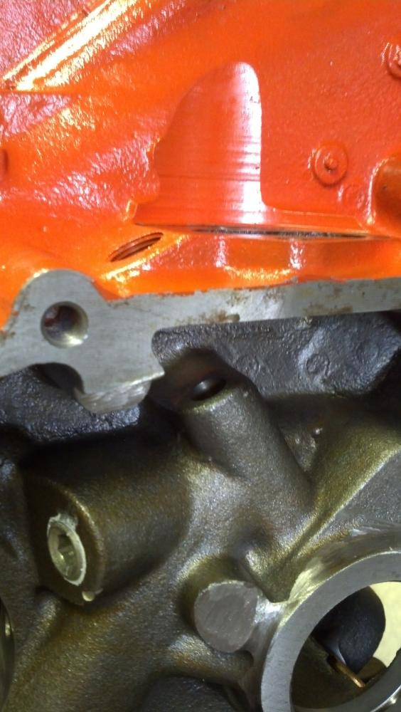

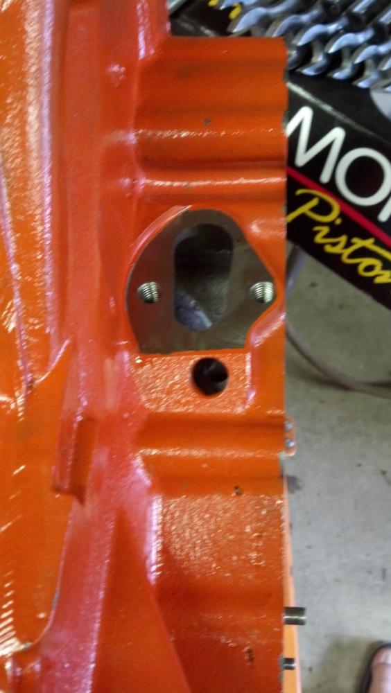

I am putting together a mopar performance 440. I am putting the plugs in the oil galleys and had a question. Do you know what the whole below the fuel pump is for? Also does the whole inside of it get plugged. I have attached a picture. Thanks for the help.

I believe it is to gain access to the fuel pump actuating rod that rides on the camshaft.
Yep, that's how you get the fuel pump rod in and out. You just plug it off once your rod is in.
Oh okay. If I am using an external fuel pump should I plug off where the rod sits internally as well?
