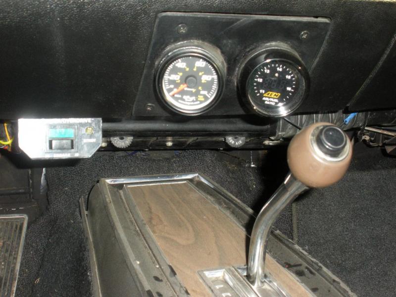

I installed an Air/Fuel meter made by AEM. It uses an oxygen sensor in the exhaust system. The guage looks like the one on the right...
I'm pretty sure Demon carbs have transfer slots as well. The primary side slot should be adjusted so only a small square is visible from underneath (0.020). If you need to readjust your idle use the secondary adjustment. Or it may need a larger squirter on the primary side.
