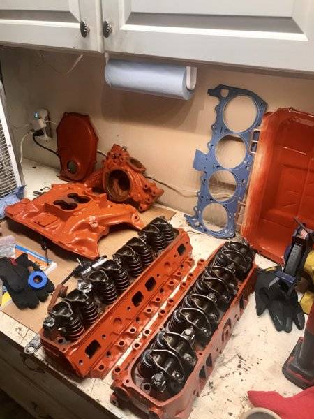

Thanks. Using felpro head gaskets. Nothing fancy.
A couple tips:
1. Clean the head bolts and run a tap in the holes in the block.
2. I put light oil on the bolts, use the torque sequence pattern.
3. Do the last 10 ft*lbs in 5 lb increments and check again after the final torque.
It's recommended to recheck the torque after some heat cycles, no-one ever does.
But it sure would not hurt.
Sounds like a fun project.
The head bolts just need oil
Standard sequence, let sit several days. If you can re-torque after a warm up.
Fel Pro teflon gaskets don't use sealer, only steel shim use it.
