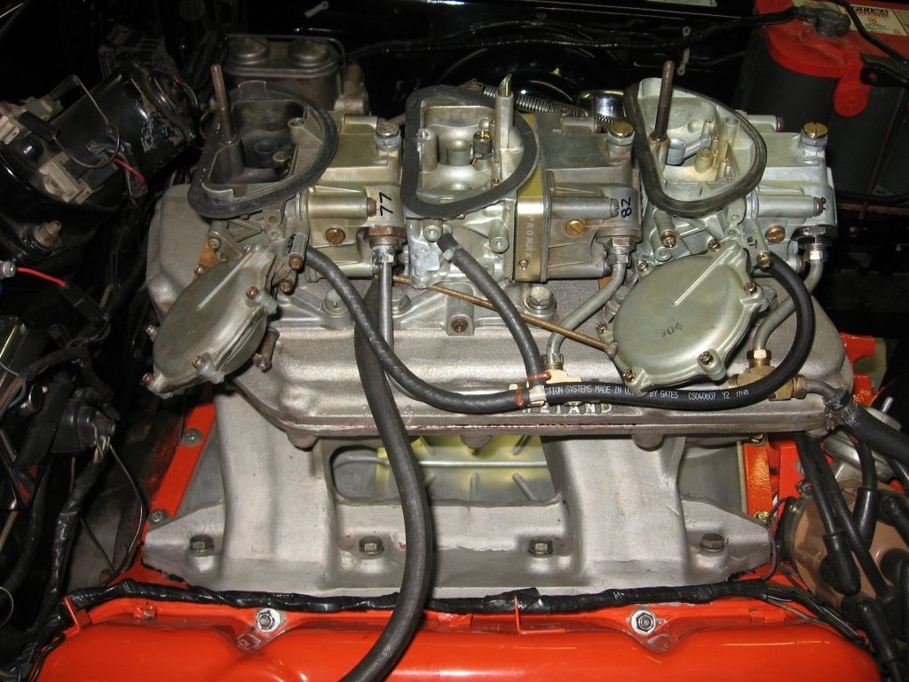

I believe this is the intake mentioned above. Yes there are lots of modifications published in the Mopar Encyclopedia Engine Book. All were performed on this one, and it won't run nearly as fast as my stock 6bbl intake. I messed with this thing for years, and multiple motors. Finally I gave up on it. My buddy had to have it. He mounted it on his car and it slowed down by .4! I like to tinker, but that thing owned me!!View attachment 375991
Damn, hard to believe the Weiand would not work well.

As recall the STR & Rat Roaster manifolds were really hard to tune. I thought the Weiand six pac was pretty straight forward. Don't have any direct experience though. It took me a while to get my stock six pak set ups to work well. Too much bullshit from Chrysler guys. I doubt my stuff would be at all competitive in the SS wars. Lots of technology needed there.
STR 14 wasn't bad to tune at all. The Weiand six pack tunnel ram was a disaster!

...the fact that it was a "disaster' shows I don't know too much...lol. I just spent a lot of time with the Weiand and the STR-14. The STR was a cross-ram though...not a 6-pak.
I think the STR had a couple different tops you could put on it. One for a single 4 barrel, and one for three 2 barrel carbs. I have seen pictures of both tops. When using the six pack top, you had to modify the manifold to make it (hopefully) distribute fuel better.
