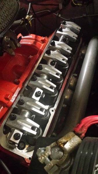

I just put a motor together last summer with them. A nice set for the money.Look just like the stock heads. Only aluminium...The guys were really helpful. I got about 100 miles on the motor. It's a beast! If it wasn't for the charging problem I'd have more miles on it.
440 with a .030 over bore
Steel crank with Icon pistons
Bullitt camshaft solid flat tappet I believe the duration 255 @ .050 the lift is .582
Harland sharp 1.5 rockers
You will have to do some minor grinding for the push rod clearance. Other than that there pretty much a bolt on product.

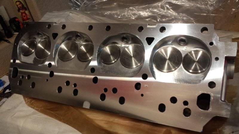

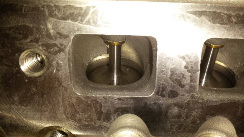

I got a set in a package deal when building my Duster. Took the to the machine shop to check valve job etc. Had the seats and valves touched up, then vacuum tested. Had to replace 2 exhaust seats because they would not seal. Shop said when they were installed went in cocked and got some shavings under them. Also said when installing seats another seat popped up from driving seats in. I said stop any more work and got a set of TF 240s. Had them checked and were perfect. Sold the 440s and let the guy know what’s what.
Loaded heads or a crate engine. You MUST disassemble and check everything or your rollin the DICE!!:poke:

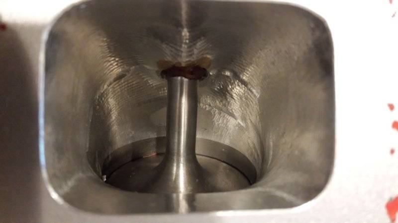

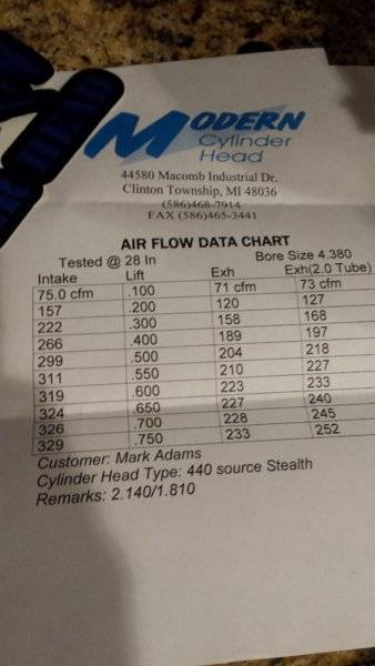

Mine are cnc ported, different springs, 10 degree locks and keepers. Nice heads.
440 + .040", 800cfm Edelbrock AVS2, Holley SD intake, Hughes STL-3842 cam, 1 7/8" Headers, 2 1/2" exhaust.
