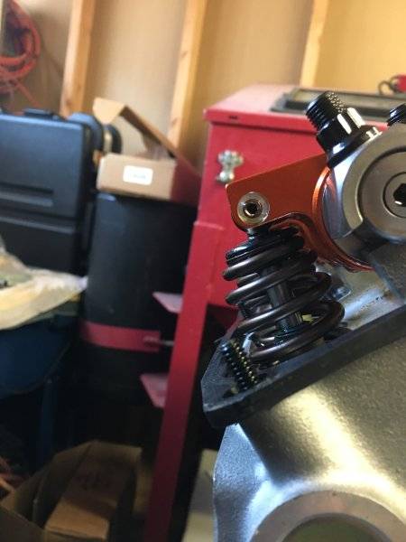

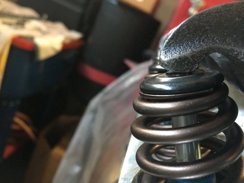

On my 440 source heads, I’m running 1.6 Harland sharps for Edelbrock heads (SHPS70016KE) and 3/8 .080 Manton pushrods. I found that if I used stock geometry rockers ( aka 1.6 crane irons) , I needed to clearance p-rod holes with .550 ish net lift. But with the Eddy style Harland’s I didn’t. Also the geometry and scrub pattern was way better. Geometry with the crane iron rockers sucked with these heads. Geometry sucked with Isky Irons and standard geometry Harland’s too. Bummer that they are nearly a grand at Mancini, maybe Shannon’s can cut you a deal.
Eddy Harland’s
Crane Irons
Isky Irons

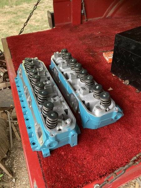

I used Smith Bros 5/16" thick walled pushrods and I had to clearance the heads because they rubbed. Not much but enough that they left a witness ring around the pushrods. And that was handcranking the engine. I want to say it was close to the base circle. At lift there was no rubbing. Hughes STL3842 cam.

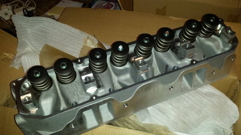

Here is what my Stealth heads looked like ootb in early 2017.

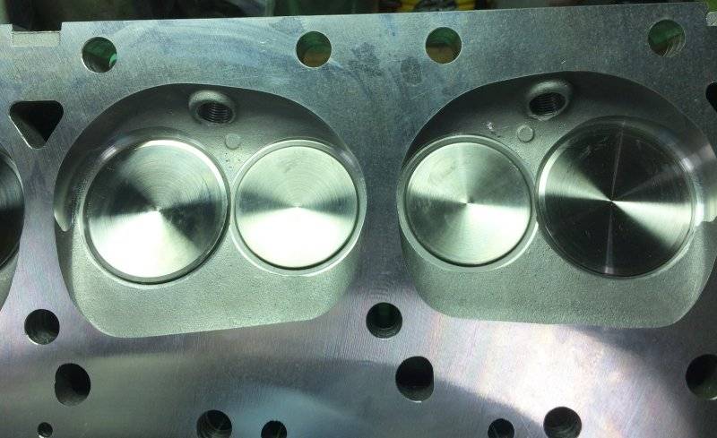

Shop said the second exhaust valve on each head was off center about .020. When the valves were unshrouded the chamber was opened up more. That chamber wound up being about 3ccs off. I had to open the rest to match. Look at the comparison of chambers before CC ing
