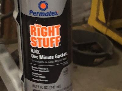

Have you tried THIS stuff?
NOTHING has worked for me as well as this product. I use it with the black fibrous gaskets on my engines...
