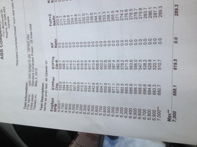

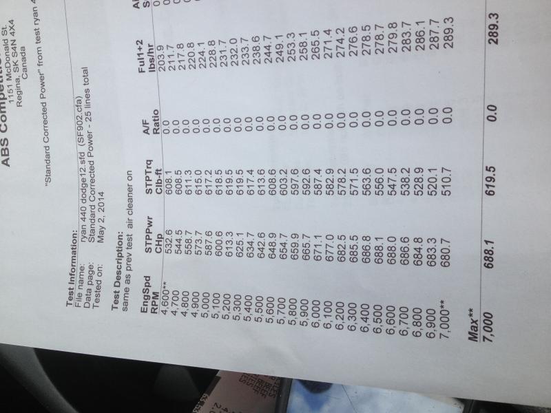

Had the engine on the dyno and made some really good numbers. Made 688 hp@6500rpm and didn't go below 680hp from 6200-7000rpm. Made 620 Ftlbs@5200rpm and didn't go below 600ftlbs from 4600-5800 rpm. Should be enough to get the car moving. Not bad for 446CI.

Yes I here ya... The previous build was the same cam and lift with ported 906 12.2:1 comp and the fastest it went was 10.74@127. Good heads but unfortunately they were cracked. So the victors payed off and I should be in the low tens. Less weight as well. Dyno sheet for new combo below
