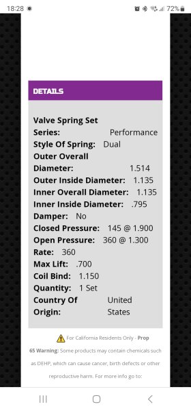

What springs are on the heads, and they are set up with what pressures?
That seems like it would be fine for solidly over 6k.
