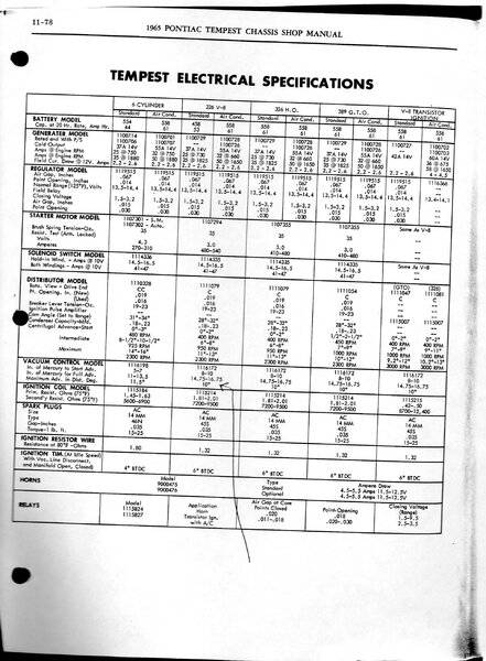

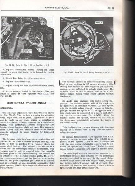

Geof Did you read the section in your pontiac book about AIR distributors. Double action vac can, that is connected to both mva and Port Vac. At idle, the Vac Can retards ignition timing and when throttle blades open it returns to initial setting.

The following stories are about Pontiacs, but apart from the logo on the valve cover, they all work the same; pistons go up/down; valves open/close. But what does vary between them are actual numbers, but not by much. Eg, iron head Pontiac runs best at WOT with around 34-38*. Not unlike a Ch, or Olds etc.
[1] High Perf Pontiac magazine, Dec 06. Written by Ray T. Bohacz, a well respected automotive engineer & author in the US. 'An often overlooked but effective tuning tool is an adjustable VA. These units can be bolted on to a stock Pontiac dist & allow a fine degree of tuning for better throttle response, fuel economy & idle quality.'
[2] HPP magazine Oct 06.
Owner had two F'birds. 1972 model, 455, auto, QJ carb, factory intake, 222/232 @ 050 cam, 8.5:1 CR, starting idle vac 13", 12* init + 15* VA.
1976 model. 455, manual, Torker 2, 950 Holley, 244/252 @ 050 HFT cam, 9.5:1 CR. Starting idle vacuum 8.25". 14* init + 12* MVA.
Both engines had 36* @ WOT.
Results 72 model. '..from ported to MVA, idle speed immediately increased about 200 rpm. After preliminary adjustment, idle quality noticeably improved & vac jumped roughly 1.5". The load generated by placing the trans into gear seemed to affect the engine less, another indication that it was operating more efficiently on the available fuel mixture. A definite improvement on idle, initial take off & light throttle acceleration characterized the overall effect of MVA over PVA. We did not however expect or notice any real difference in part throttle response over PVA. What we did discover though was a smoother transition when re-applying the throttle after coasting at speed..'
Results 76 model. 'The available advance of the aftermarket VA was limited 14* [ see my comment below].....Once installed & connected to man vac, idle speed increased....After resetting the idle speed & readjusting the mixture screws, vacuum increased about 3". The large cam seemed much tamer & idle quality was smooth & stable. Subsequent road tests proved that the engine was largely unaffected by clutch engagement, & acceleration was smooth & effortless. Surging however was still present, although not nearly as severe.....We ultimately limited static timing to 14* & VA to 12*. This limited surging to extreme driving conditions & reduced idle vac 0.5" but there was no detectible loss in idle quality or low speed street manners.'
[a] For this test a Crane VA unit was used. As I alluded to in an earlier thread, these have a sleeve inside which limits the total VA. The 76 could have used a lot more timing but the testers were probably unaware of the stupid sleeve that limits movement.
Increasing the IFR would probably have cured the surging or at least reduced it. This was caused by the large cam duration, NOT MVA. Would have done the same with PVA because at cruise they behave the same.
