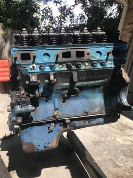

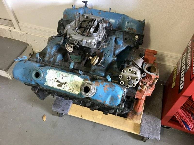

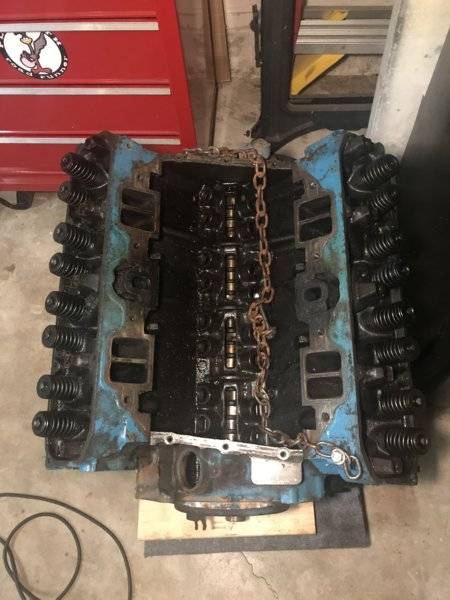

I bit the bullet and bought a ‘78 440 yesterday. Taking it to the machine shop for cleaning and inspection this week.

Question 1 of 100: Engine has a huge thermoquad on it. Is it worth rebuilding or use my 650 Edelbrock AVS2? 650 seems a little small?
Can I use that oil pan or get a center sump?

I jusr read through some carburetor info and see the thermoquad is highly recommended for street use

2. I would lean towards using the Thermoquad carburetor. The only problem I see is IF you want to run an air grabber hood and/or factory-style air cleaner. I "think" (not positive) that the throat of the Thermoquad carburetor is too big vs. a stock 1970 air grabber (or dual snorkel) air cleaner. Otherwise, a great carburetor.....small primaries for mileage, BIG secondaries for "giddy up" and you already have the correct intake manifold for it on your 440.
I’ve always liked the sound of a Thermoquad at full song! You may eventually want to upgrade that 8 1/4 especially if it’s a non sure grip.

Thermoquads have a bad rap IMO. I have an AVS on my 440, but if it acts up or does not perform very well, I would not hesitate to use a thermoquad.
