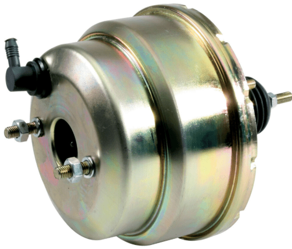

Agreed, 15"HG should be more than enough for the brakes & to satisfy a power valve/power enrichment circuit... Tuning & a brake booster issue... BTW if you booster looks like this one it's made by CPP & should probably be thrown in the trash...

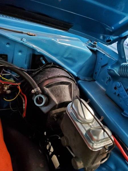

As for the power booster, picture shows the one in the car. Does this one fall into the "trash" category?
