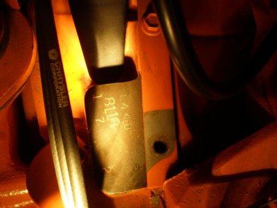

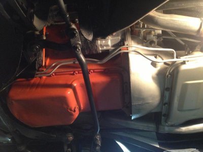

Greetings,
I am sure this has been an age old question relative to how many quarts of oil does a stock 440 takes. I have read many postings before I changed my oil in my new classic for the first time so I purchased 5 quarts of oil plus a K&N HP3001 filter. At the end of my work I started the car and let it sit for 30 minutes. After 30 minutes the dipstick was right at the ADD mark so I reluctantly installed 1 more quart of oil. Dipstick now reads FULL.
The problem I am having is that most manuals and past forums say it should be 5 quarts with filter. It looks like the stock dipstick and a factory Mopar oil pan. It is a 440 E Series block from 1969 that came out of a C class Polara or another large car. But who knows what dipstick and oil pan was P9030197.jpgs really used to rebuild the engine. With these non-numbers matching classics its anyone's guess what you really got.
any comments appreciated.
ps: how would I tell if I have one quart too many in engine even though dipstick reads FULL ?

my stock pans are 4 plus 1 if changing filter
Most of the BB pans such as the 402 are 4qts plus 1 w/filter which I call a 5qt pan. Early Hemi pans were 6qt and 68-71 Hemi were 7qt. The 72B 854 is a 7 qt. Truck pans are 6qt but aren't a center sump pan.
The pan in the above pic has a deeper sump than the 402's and such.
Thanks for quick response. I am glad I posted the photos. I never thought to see if by chance oil pan had some sort of part number stamped into it.
Thanks again........
Some have the last 3 of the part number on them.

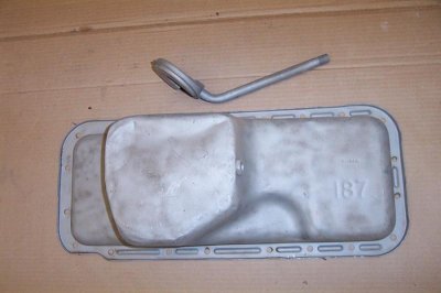

My pan came off a 1972 or 73 400 engine. I checked it when off the car, and it held 6 QUARTS to the bottom of the windage tray. So I run 5 quarts in the pan, 1 in the filter, for a total of 6 on an oil and filter change. And when I check it after changing oil, it comes right to the FULL mark on the dipstick. It is noticeably larger than a 70 Super Bee pan which has the baffles in it. That pan takes 4 quarts, 5 with filter. So I feel it best to go with the full mark on the dipstick. I'm sure I could put 6 quarts in the pan with no problems, but its working fine as it is so will leave it at 5 in the pan.
I think my pan has a 699 stamped into the bottom. When changing pans be sure to use the pick up tube that came on the motor the pan came off of.
699 is a C-body pan that also works well fitting a BB into an A-body. Should be 5qts w/ filter.

You talkin to me? lol. The 187 in the pic is a 5qt w/ filter C-body pan.

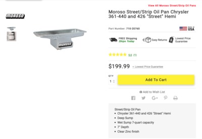

Hello.
Sorry for grabbing out this old post. But I have similar problem.
I have a 440 engine from 1969. And I have a Moroso 7 quart oil pan.
And I´m using a noname aftermarket dipstick....
How much oil should I put in the engine? I would like to know it one time, so I can put a mark on my dipstick. I´m not so firm with the us - units of measurement.
Does a 7 quart oil pan mean, that all in all I have to put 7 quarts in the engine? Or is it just how much goes in the pan, plus filter and engine itself?
